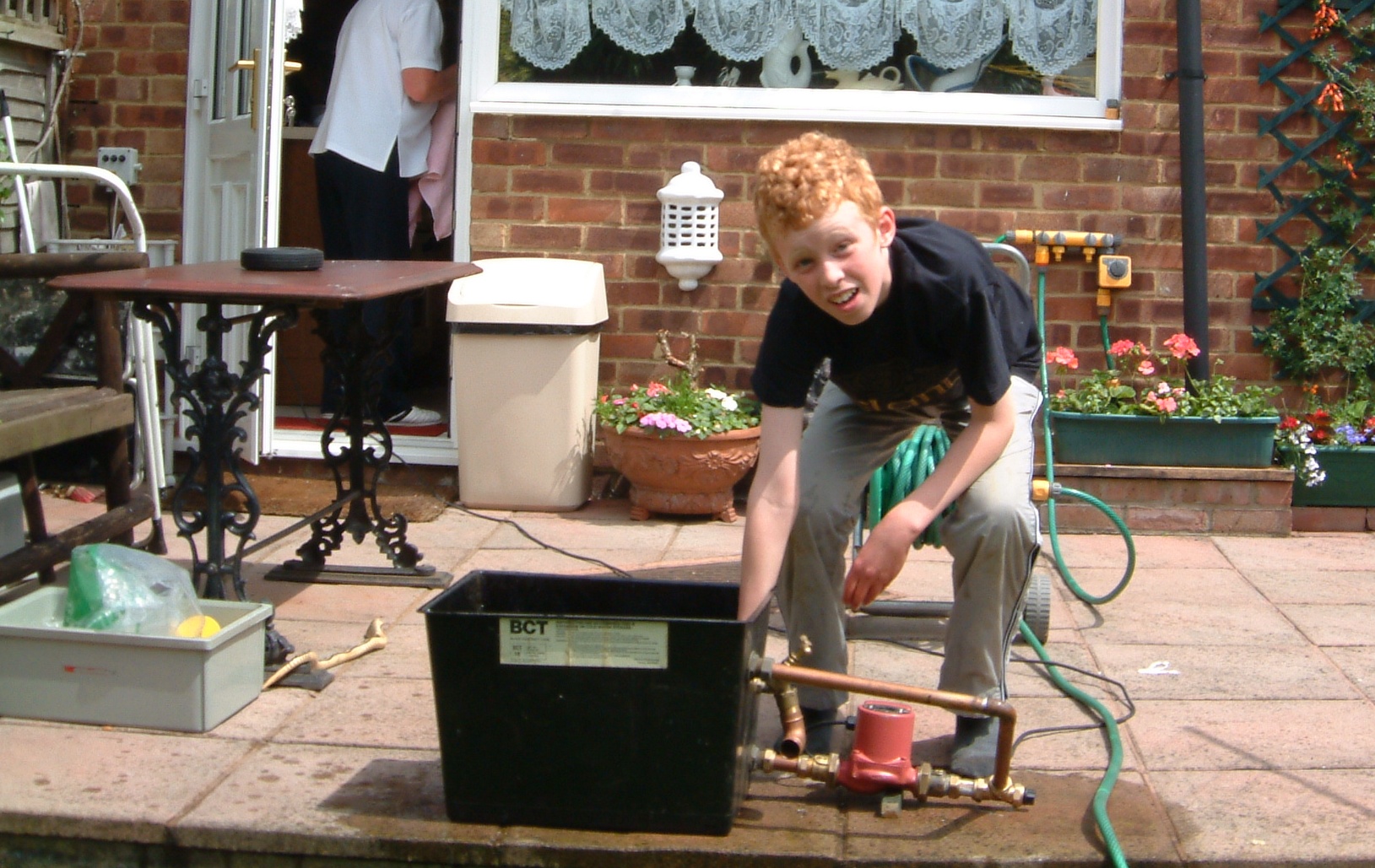

Picture below is me cleaning the old back boiler out:

Us gas engineers would never use a CO meter to detect a gas leak ;)
Nice old photos though. Wish I had some with my old man.

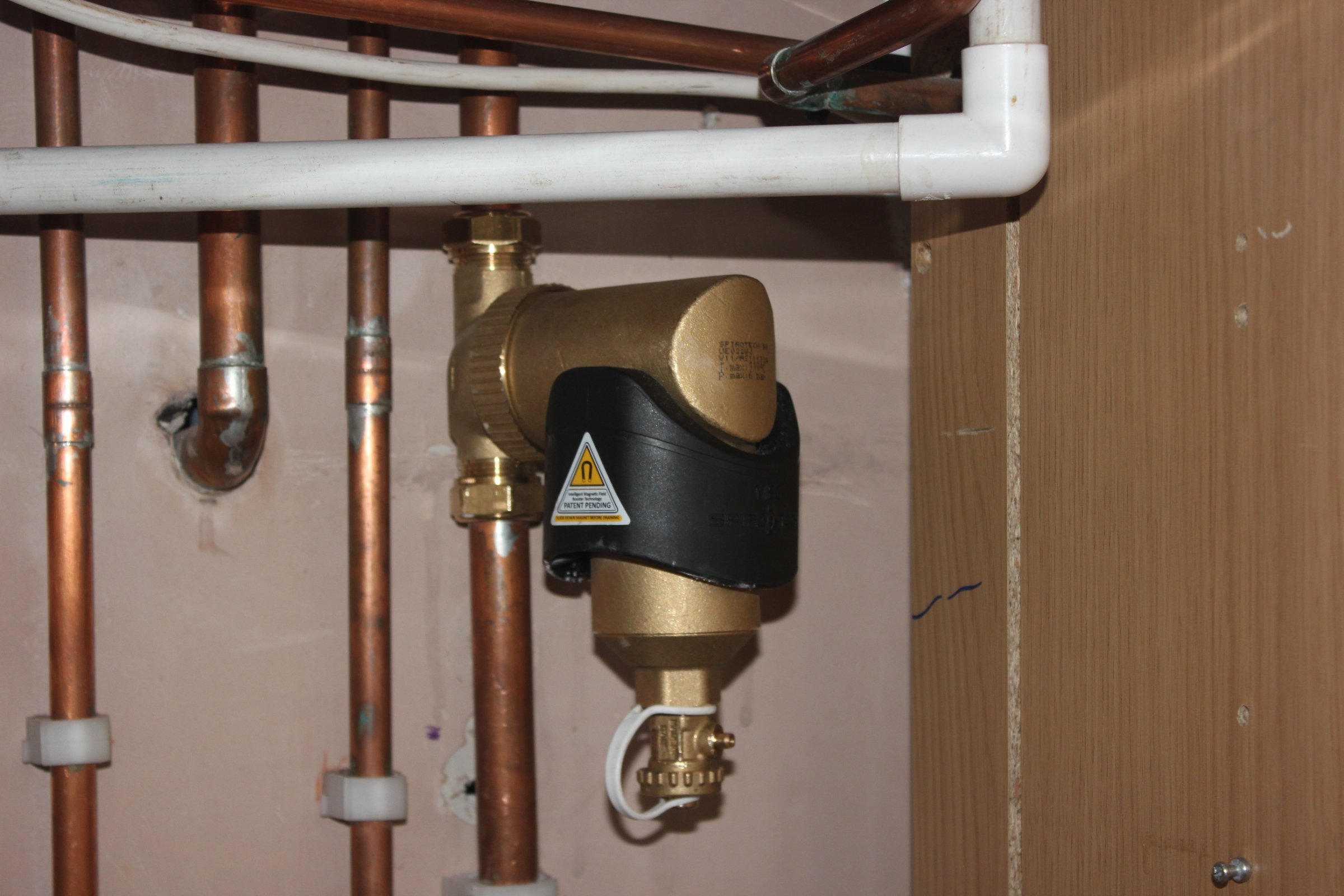

Also, my Spirotech MB3 came today; I have a mini pipe cutter, but I only have a fingers width between the return pipe and the wall. Don't really want to use a hacksaw as pictured by the MB3's instructions, but o-well I guess I will just have to see how I get on with the pipe cutter first.

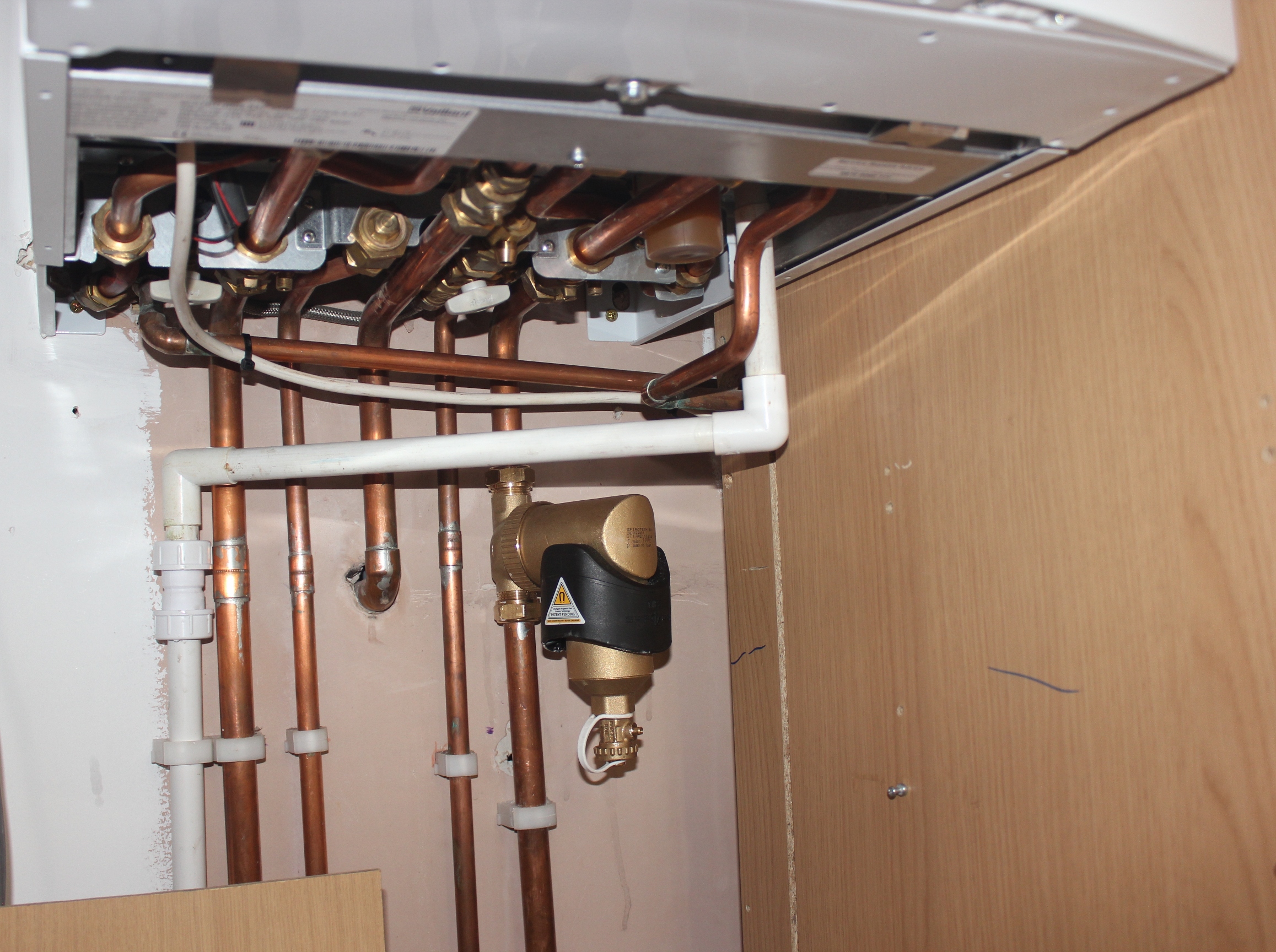

Just an update, I have now installed the SpiroTech MB3 Filter. Not bad for some one who is not a plumber by profession, although one of the more simpler jobs I guess.
Also flushed the system out with the Fernox F5 express cleaner before and then of course put in the Fernox F1 express inhibitor in afterwards.
Oh, and for those who are wondering what my boiler is, it is a Vaillant ecoTEC Plus 937.
Also, should I put another bottle of the F1 inhibitor in the system or is the 1 enough? While I only have 10 radiators, it's a 4 bedroom house and a lot of the radiators are double or large-ish ones.
