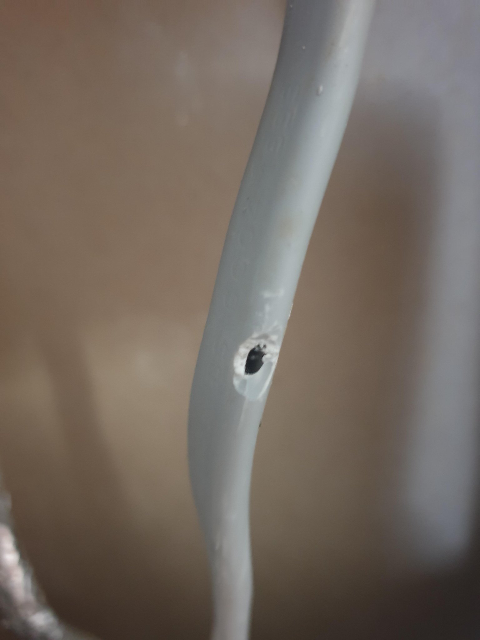

Image (2) is the 2.5mm2 cable nick turns out it was only through the outer sheath and did not go through the inner sheath no sign of exposed copper.

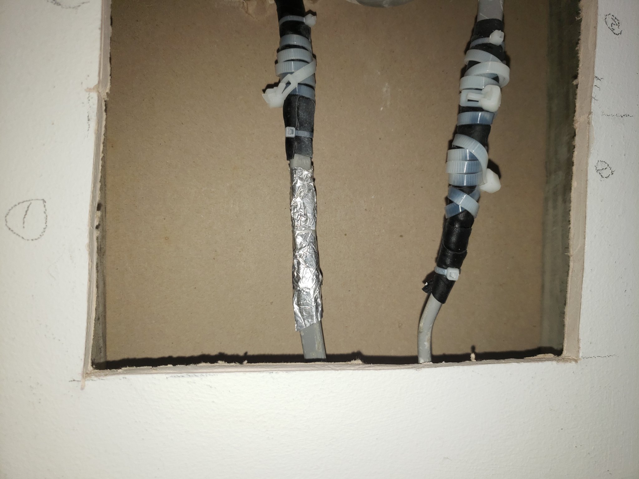

Pic (filename ending ..535) I decided to wrap electrical tape around the cable, then put waterproof tape over that and then use cable ties to make sure it stays on

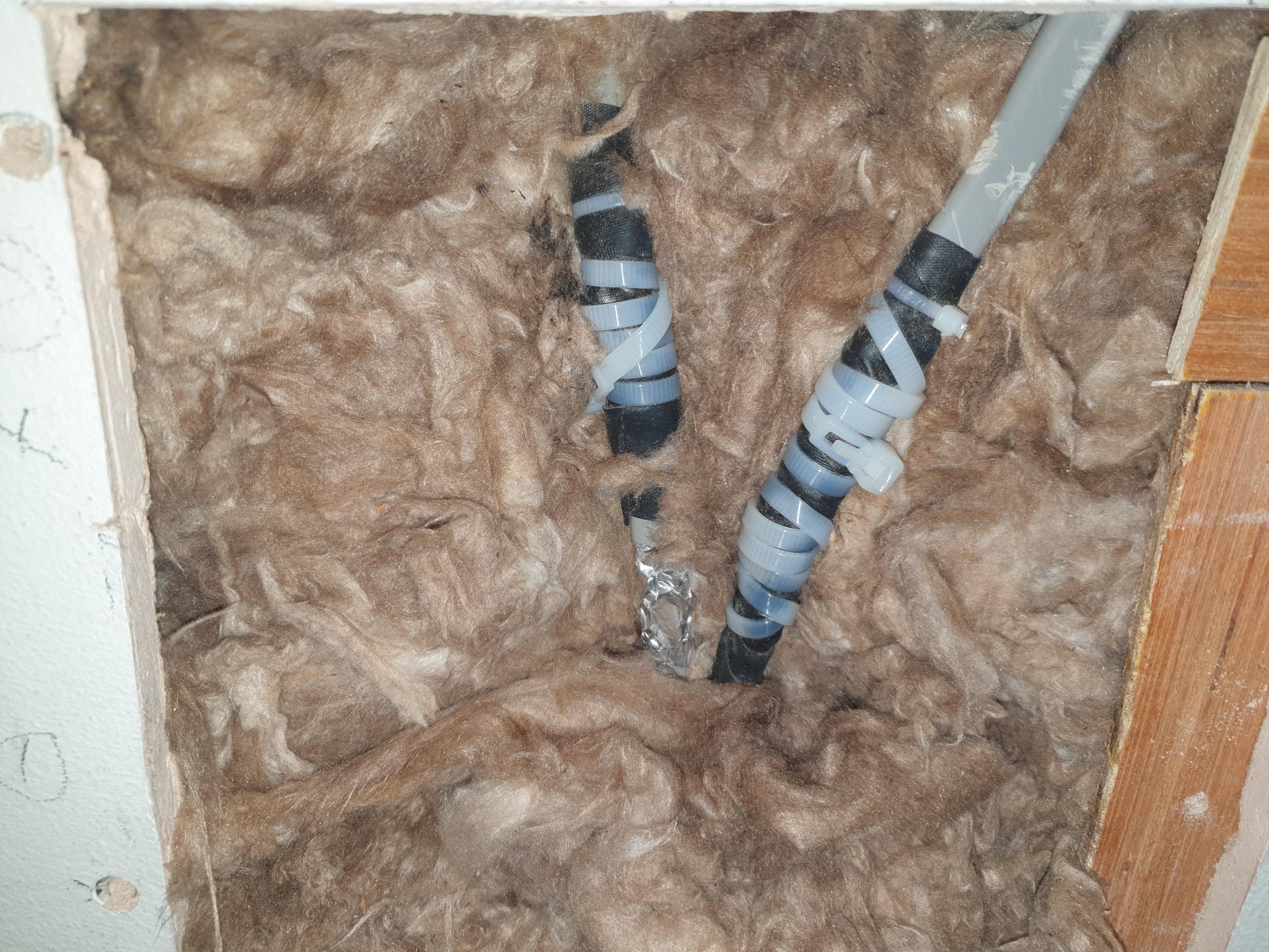

Image (8) is final and shows the partition wall filled with mineral wool with cables at 50% depth
All I can say to that, is good grief! Well and truly, well over the top, for a tiny nick to the outer. At the most, a single layer serving, over the top, would have been perfectly adequate.

You originally reported 'a' cable nicked, your photos suggest you have in fact repaired two cables - why?
Well the property has enough problems without adding risk of electric fires to it.
The other cable had a fraction of of a mm shaved off about 1cm2 of the sheath on 1 side (didn't even go through the outer sheath) which is actually really hard to see except without being right up close. I decided to 'belt and brace' to make sure.
Adding that amount of thermal insulation, is marginally adding to the risk of fire, rather than reducing it. Cables rely upon a cooling air flow, to help dispose of their internal heat.
The sheath, is the outer protection from mechanical damage, usually grey. The insulation, is the brown/black/red/blue, beneath the sheath. Damage to the outer sheath, is of much less consequence, than damage to the insulation of a cable.
Do mice/rats eat through electrical tape and waterproofing tape? I saw some partially chewed cables (in a different property years ago) due to rat damage
